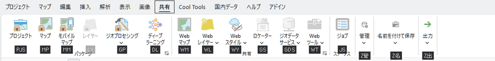

Ever since ArcMap, I've used the keyboard shortcut "Alt+s" to save feature changes, and it's been very useful.
However, after updating to 3.4, pressing "Alt+s" now selects the "Share" tab, making it difficult to save. (What's more, the word "Share" is surrounded by a box, and the word appears in a black box as well.)
How can I make saving take priority?

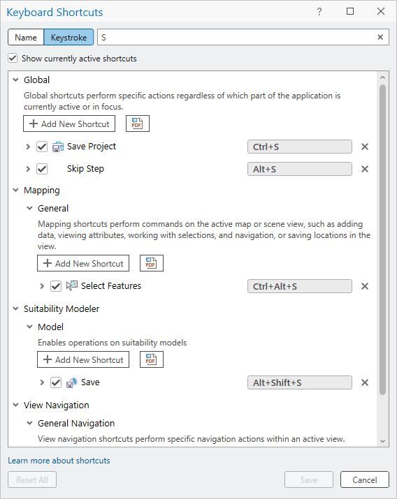

In ArcGIS Pro 3.x, CTRL-S is the keyboard shortcut to save a project.  In the Keyboard Shortcuts UI (see images below), you can search for and find many of the shortcuts available in ArcGIS Pro.  Furthermore, you can create your own keyboard shortcuts as described here in the help documentation as well as all the other ones available in ArcGIS Pro.

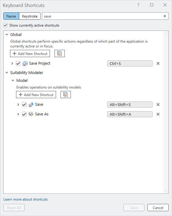

At the top left of the Keyboard Shortcuts pane, if you click the Keystroke box and type S in the box to the right of the Keystroke word, you see all the keyboard shortcuts that use "S".  It appears that Alt+S is already being used for the Skip Step shortcut in the Global group.  I "think" you can delete this keyboard shortcut by clicking the "X" to the right of the box that contains "Alt+S"  Then you can use/create/apply the Alt+S to be used for save on the edit core tab.

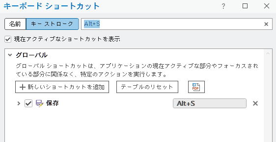

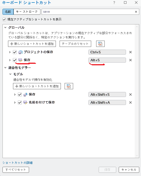

Sorry, I didn't notice your reply.
I already removed the Skip Step shortcut when I set the Save shortcut.
If anything, this black box looks like a shortcut for the ribbon.
If you press and release only Alt once, the shortcuts for the tabs and quick toolbar appear. It's very similar to that.
It seems that the shortcut for the ribbon has been set, and the previous shortcuts are disabled or conflicting.
