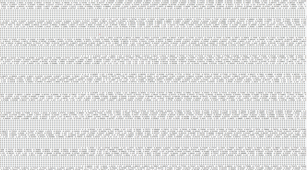

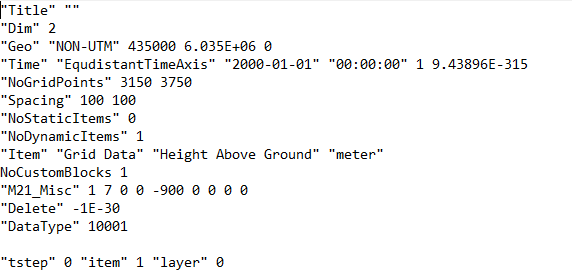

The file in question looks like this when opened in Notepad:ascii_photo.pngascii_values.png

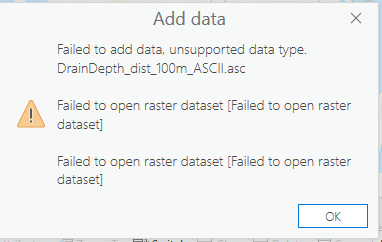

But when I try to either add it straight to my map or when I try to use the Copy Raster tool, I get error message.

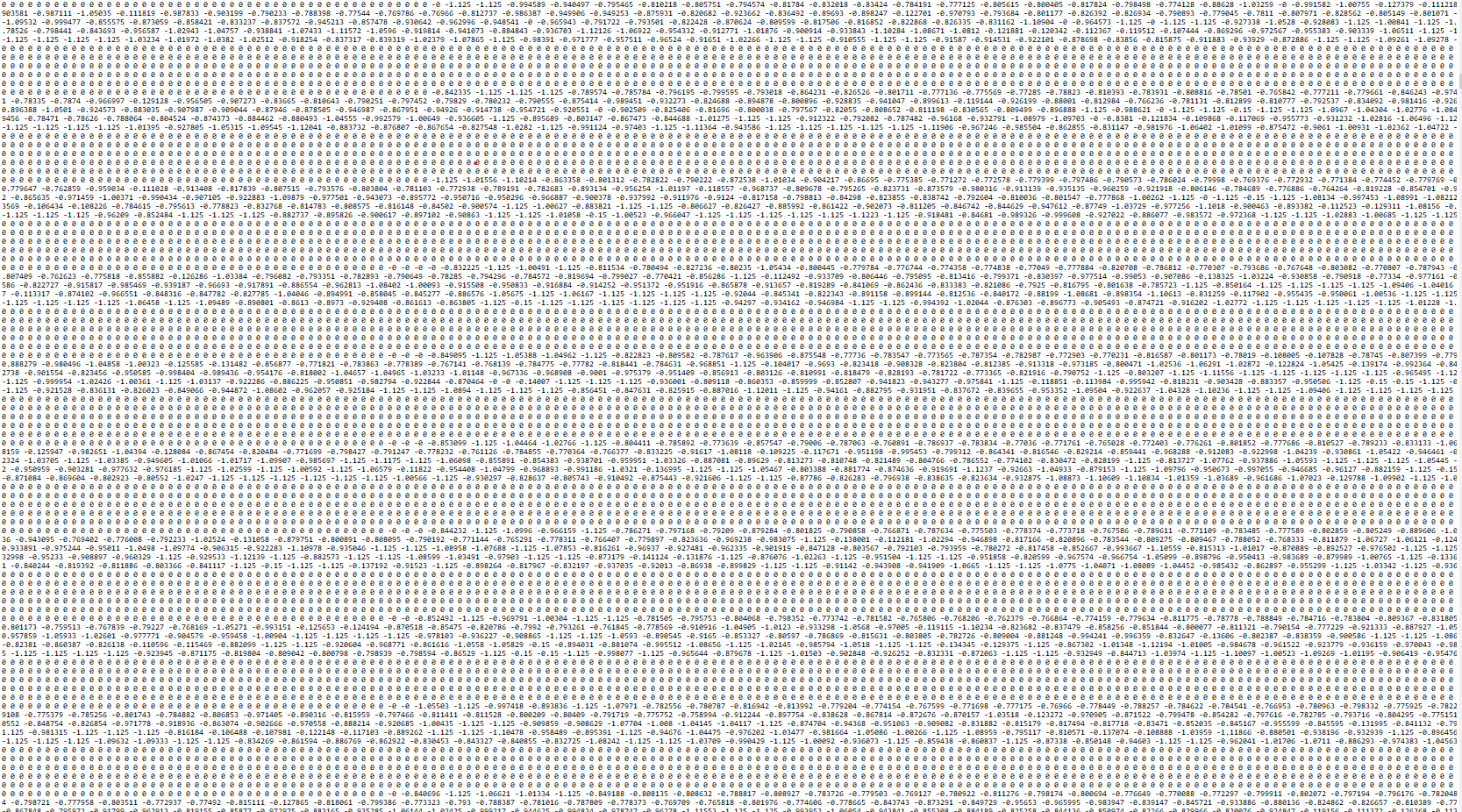

I also tried with a file which has a courser grid of 500m instead of 100m and create a raster out of that .asc file, but it gave me the same error, and the .asc look like this.
I don't know if it's the file that is the problem or I am using a wrong tool.

I don't know the dfs2 format or export options, just posting to say that what you show is not an Esri ArcGIS ASCII format grid.
