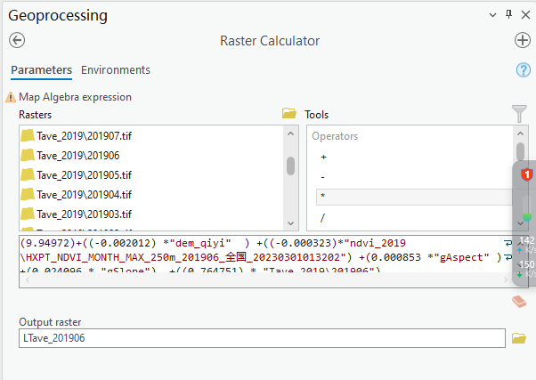

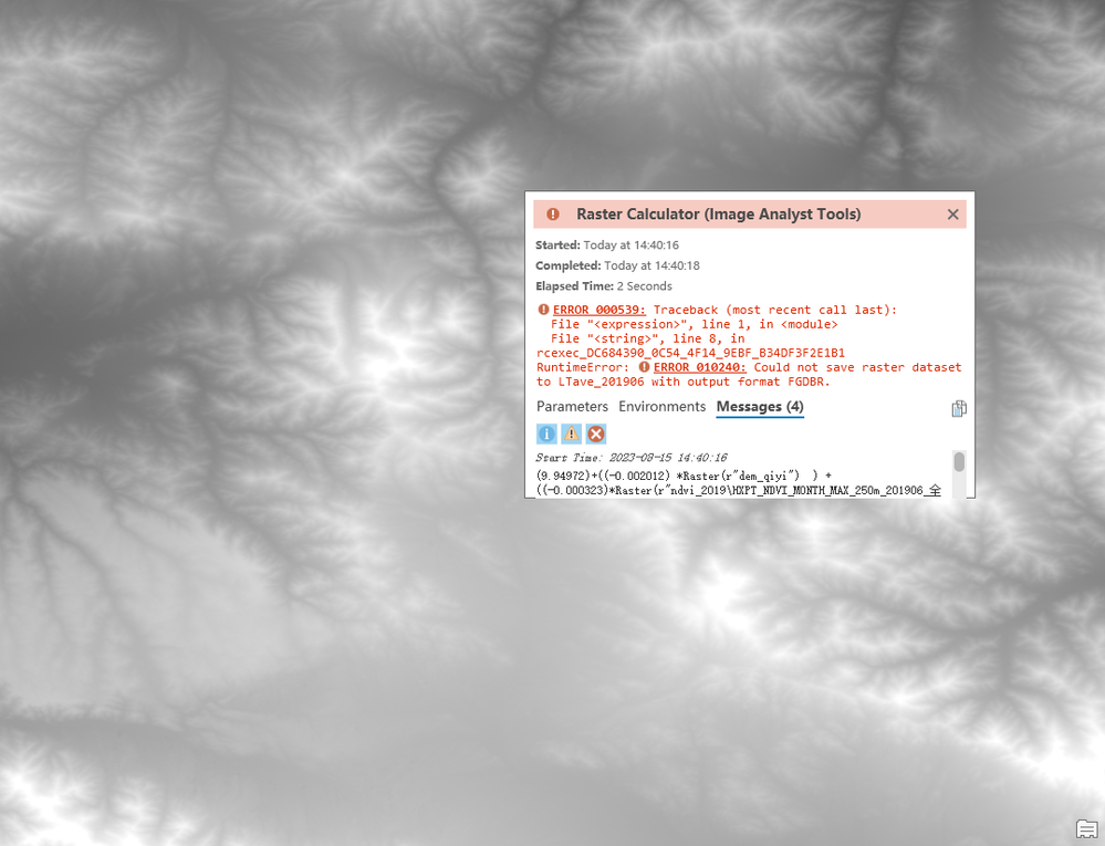

When I use the raster calculator for downscaling analyses, I suddenly get error010240 when proceeding to 2019, previous processing has been without this error.
I still can't fix it after trying some changes to the output file format as well as the output file path. When I change the output file format to .tif it tells me that I can't output this format, which confuses me.
819f7dcce468547aaf000723846e4f32.PNGef1db3176c80b0477a6fa5c5dc7fd580.PNGI would like to ask what I should do to fix this error.

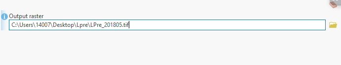

BingyuCui
I've tried changing to output to a folder instead of a database with a .tif file extension and still get the error.

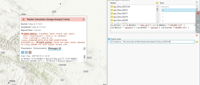

DanPatterson
MVP Esteemed Contributor
hmmm try a local non-One Drive folder... there are issues with them as well as paths with spaces and punctuation in them
... sort of retired...
BingyuCui
Thanks for your reply, it still doesn't work.截屏2023-08-16 11.01.36.png截屏2023-08-16 11.01.53.png
