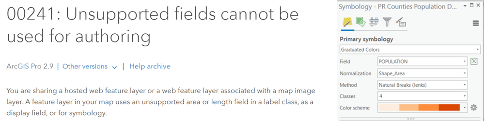

I receive this Error during the Share As > Web Map "Analyze" step.
Why is a common density map that normalizes by 'Shape_Area' a problem?
...In addition, why is this layer even a problem when it's not visible and not meant to convert to a Web Map with the other layers?
See below: Thanks

I wonder if it's because the Shape_area field is a reserved ArcGIS field name and likely would update to the Web Mercator projection of a web map/web layer. Just a guess on that one though. One thing to test is to create a new attribute field (float or short integer), do a field calculation to get an area value, use that in the Symbology pane and try the workflow again to share as a web layer.

In looking at the internals, there is some chatter about bugs in the ArcGIS Pro 2.8.x realm where if your DISPLAY field in layer properties and in the Label Pane -> Label Class field were set to shape_length it would throw the 00241 error. If you change it to say ObjectID, then the error code went away. What are your two values there?
