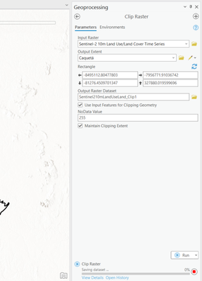

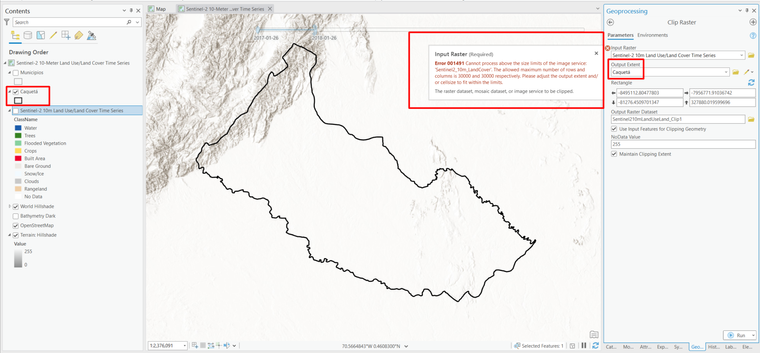

I have encountered this error in the past clipping the Sentinel-2 10m Land Use time series. You should have an error like this:

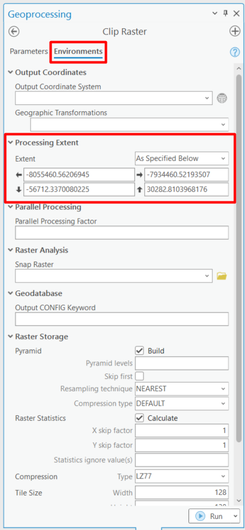

To solve this issue, you need to modify the processing extent of the clipping tool. Additionally, try running the tool with ArcGIS Pro in offline mode. Attached find a screenshot of where to modify the processing extent on the environments tab of the geoprocessing pane.
When you reduce the processing extent the error no longer pops up and you can run the tool. (It will take time to run though)
I hope this information can be useful for you,

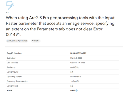

Hello @KatieWalker1 & @AndyDixon ,
I found out that there is a reported BUG on this issue, it is BUG-000156399.
You can check more information about it here: When using ArcGIS Pro geoprocessing tools with the Input Raster parameter that accepts an image serv...
This issue is addressed in ArcGIS Pro 3.2.
I hope the information is useful,
