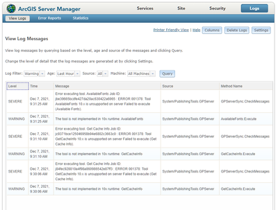

And ArcGIS Server Log as below:
Any help is much appreciated.
