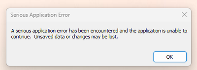

I want to change the graticule from the default of degree, minute, second to decimal degree.  When I click the 3 horizontal bars to change to decimal degree, ArcGIS Pro 3.5 crashes. If I right-click "Black Horizontal Label Graticule in the TOC, and select "Properties," nothing happens. Is there a way to change the default graticule to decimal degree?  Thanks.

We are aware of this crash and working on a fix. In the meantime, are you trying to change the way the labels are displayed on the graticule itself? The menu button changes the input format, so you can type the desired intervals in decimal degrees. To change the labels on the graticule, you have to change the label format to decimal degree. That should work without crashing.

Can replicate.
New Project > New map in GDA2020 > add new layout > add graticule > change dms to d and voila:
Lodging case with locals now.

Okay, yes, that worked.  In the "Format" box, I changed "dms" to "d" and changed the decimalPlaces to "3". It would be preferrable to be able to change that on the fly using the 3 horizontal lines, however.  I can do without the application crashing. I'll accept this as a solution but please keep working on the fix for the crash.  Thank you.

Bug Nr: BUG-000178673
