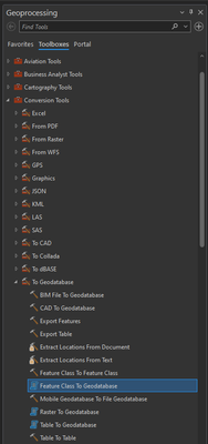

I still don't know what's directly causing the error. But, I was also able to use the tool directly from the Conversion Tools toolbox. And as far as copy/paste goes it didn't seem to be an option?

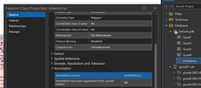

Two weeks later and I still can't export street annotation to fgdb.
A couple things I didn't mention are that I tried exporting both in layout and a map. And the layer shows up in the fgdb, but there is no annotation when I add it to the map.
In the Properties menu the Anntation Version is ArcGIS Pro 2.x. I wonder if this has anything to do with the error.
