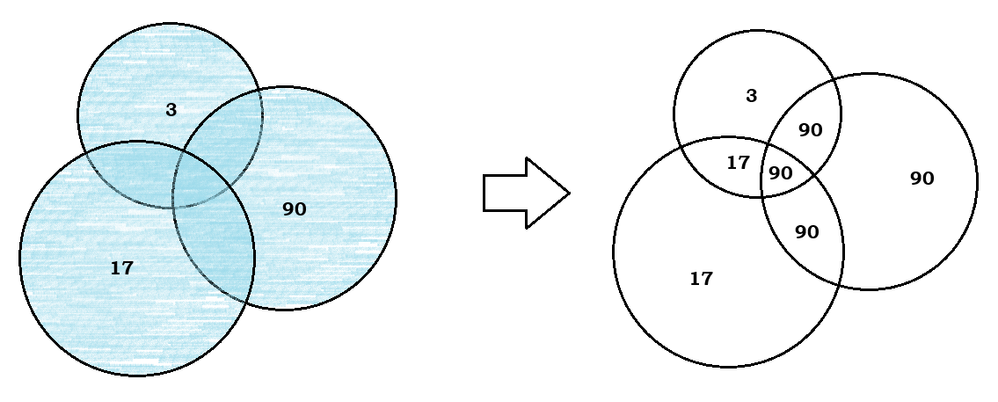

I am curious if there is a way to complete this task for use within ModelBuilder- for a feature class with thousands of records.
I have a polygon feature class filled with buffered points, so many circle features of the same size. Many of these features overlap with each other in some way. The feature class has an attribute table of fields, one of which is 'Priority', which is an integer type ranging from 1-100.
The goal is to identify and isolate any given overlap areas (sometimes more than 2 features overlapping), and based the value in the 'Priority' field, to only keep the polygon with the highest value. The output layer should have the same area footprint, though only one layer features that does not overlap. All attribute fields should be kept intact for the features that are preserved.
Using the below graphic as an example, the four new '90' value features in the output would have matching attributes to the original '90' feature within the input (aside from the default geometric fields), and have no overlapping features underneath it.
If possible, would it be feasible to do so with 'Basic' analysis tools?
Thank you! Please feel free to ask questions if needed.
