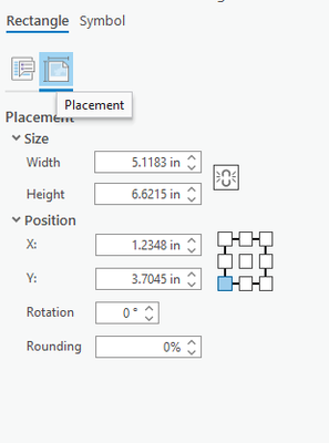

I think the problem is that you're aligning to page, not to another object.
I think it'd probably be easiest to just do the math using the Placement tabs.
