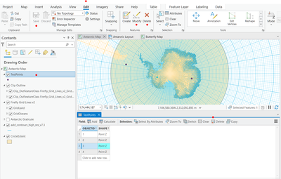

This is a fairly basic question. I'm just not sure how to fix it. From an attribute table, when I double click to zoom to a data point, ArcPro just stopped zooming. If I am then able to scroll through the map visually and find said data point, if I highlight it and either hit the delete button or right click to delete, the data point either will not delete or will "delete" only to still be present when I open the project again.
I have tried restarting the program, the computer, and have cleared the cache.

Hi Alexa,
I'm not sure why your zoom to feature isn't working...
Here's what I recommend you do to delete the points that you want to get rid of.
Open the attribute table for the feature class you are editing.
Click on Edit (top left center of screen)
Click on the row in the attribute table you want to delete.
Then click delete.
When you are done click on the save icon (top left of screen floppy disk and pencil icon).
Then save your project.
Alternatively click Edit, then Modify, then select item by clicking on it, and then Delete, Save, Save Project.
