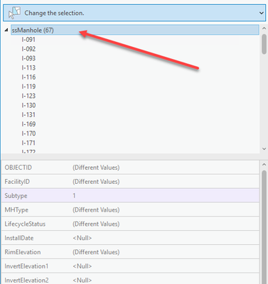

Just to make sure you are aware, if you are making the same edit to multiple features, you can click the layer name in the attribute window and any changes made will be applies to ALL selected features at once.  No need to click through them.  Unless, of course, you are making 'different' edits to the features.

Thank you for that reminder with the attribute window. Unfortunately, with this scenario there are still a lot of instances where we are making different edits to each feature.
