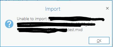

Trying to Import a .mxd into Arc pro, keep getting unable to import with no explanation. I have ran through MXDDoctor, with no faults found. have tried it save in data view and layout view. Everything is save in-between two geodatabases and source to local Drive. have to have 2 databases for project. all images in layout are also save to local drive as well.  Using 10.7 ArcMap and 2.9.2 arcpro.

Either one of those ways worked, same result unable to import

Hi, I am experiencing the same problem:
Neither "Import Map" nor the drag&drop of the mxd into the Catalog Pane works. Both result in the same error message without error code. Additionally, after trying to import the mxd, the aprx is frozen and needs to be shut down via the task manager.
