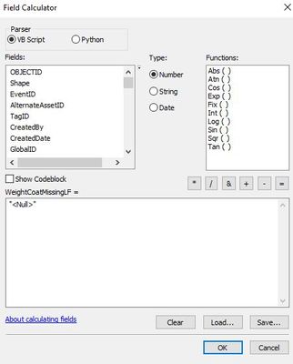

I am adding a text/string field, "<Null>", to a .gdb feature class table.
When I use Field Calculator to change, I get this error message
The calculated value is invalid for the row with ObjectID = 16666.
For example, the calculated value may be too large for the field or you may be trying to add a string to a number field.
This row will not be updated. Do you want to process the rest of the rows?

RahulPawar1
I want to put Null in the all field instead of unknown...
RahulPawar1
RahulPawar1

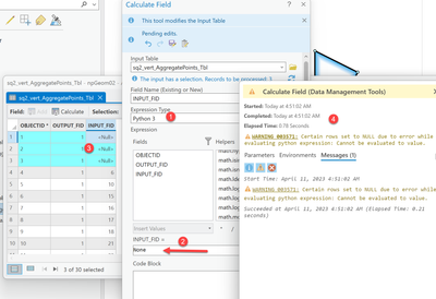

DanPatterson
MVP Esteemed Contributor
For your field calculation use
None
which will give rise to a warning... which is fine
003571: Certain rows set to NULL due to error while evaluating Python expression: Cannot be evaluated to value.
Description
A failure occurred when attempting to write a calculated value into the target field. This may occur if the value type is incompatible with the target field type. For example, the Python code returned a string value of A, but the target field is of type long.
A null value will be stored in the target field for that row.
Solution
Review the target field and identify records with null values.

<Null> is ArcGIS's way of showing that there is no value in a field.
What you were trying to do is put the string "<Null>" (which is absolutely not the same as null) into an integer field. ArcGIS can't convert that string into a number, so it errors out.
To remove a value from a field, you have to use the null value of the language you're using. None for Python (as Dan told you), Null for VB Script, null for Arcade.
