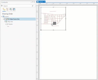

When a copy of a map is created, a map view is not opened by default.  It is necessary to open it. When you say "drawing area", are you referring to the layout page since the original question does indicate you're working in a layout?  To duplicate map frames (not maps, note that these map frames all point to the same map), you can hold Ctrl + drag.
