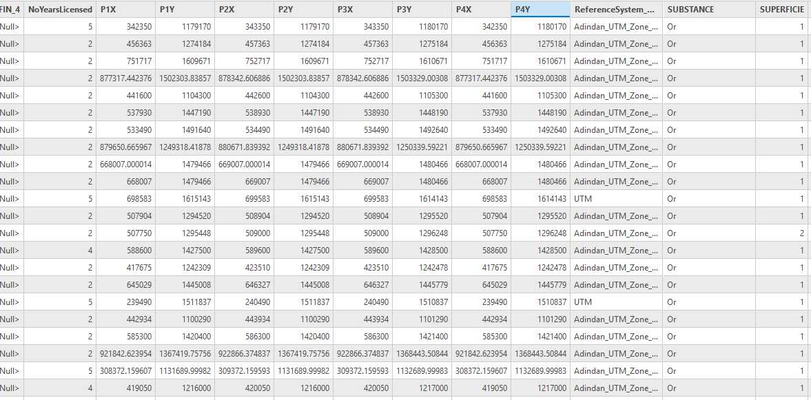

I'm trying to draw polygons based on coordinate information in a table. Each polygon consists of four vertices, and the table contains 8 attributes that store the x- and y-coordinate of every vertice separately. The table also contains other attributes I'm trying to take over to the polygon attribute table. Is there a way to directly convert the table to a polygon feature? Here's a screenshot of the table so you can get an idea:
So e.g. P1X stores the x-coordinate for point 1, and P1Y has the y-coordinate for point 1 and so on. Every row represents a polygon consisting of four vertices.

Not 100% sure on this one, but I would start by importing the table into a file geodatabase (if not done so already).  Then I would use "point to line" geoprocessing tool and then "feature to polygon" (using the line features you created with the "point to line" tool).

Quite a few workflows of point to polygon in this Tech Support article but I believe Amanda's workflow should work for you.

If interested in a python way, may want to look at this post.
That post starts with a point dataset, but the second half of the python script does exactly what you are asking.  Creates polygons based on 8 xy fields in the table and adds the 'Id' field/values to the polygon.
