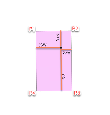

Not sure about a geoprocessing tool, but with arcpy this is pretty simple.
Though, with 4 measures from the point, it will create rectangles oriented N/S/E/W.
Basically, would add new columns for 4 coordinate pairs (X1,Y1,  X2, Y2,........Y4).
then you would add/subtract the measures from the coordinates giving you the corner points of the polygon.
Dump those points to a polygon, and you have your rectangles.
Could even subtract a certain amount from the difference, then buffer with that amount to make them rounded corner rectangles (same point as above, but minus 10 from polygon, then 10 on buffer).
If arcpy is an option for you, I can share the code that did the above.  would just need some tweaking to fit your dataset.

This is the code I used to do the above.
import arcpy
# Overwrite pre-existing files
arcpy.env.overwriteOutput = True
#####  set input point feature class and output FC for polygons and buffers
infc = r'Database Connections\pathToInputFeatureClass\testpoints'
outfc = r'Database Connections\pathToOutputPolygonFeatureClass\polygons'
bufffc = r'Database Connections\pathToOutputBufferPolygonFeatureClass\buffers'
## set the size of the buffer (in map units) for the buffered polygons
buff = 10
##  this line caluclates the x,y values of the points in fields named "x" and "y".
## can omit if you already have these columns with x,y coordinates of the point
arcpy.management.CalculateGeometryAttributes(infc, "x POINT_X;y POINT_Y", '', '', None, "SAME_AS_INPUT")
###  Expects these fields in the input FC.  "x" and "y" are the coordinates
###  the rest I added manually to the FC to hold the new corner coordsinates
###  and the distance measured in each cardinal direction from the tree
#        Index numbers to make it easier to tell what row[#] refers to.
#         [0]   [1]   [2]   [3]   [4]  [5]   [6]   [7]  [8] [9] [10]  [11] [12] [13]
fields = ['X1', 'Y1', 'X2', 'Y2', 'X3','Y3', 'X4', 'Y4','x', 'y', 'n', 's', 'e', 'w']
###  This updatecursor adds/updates the new corner coordinate columns
###   the "- buff" subtracts the buffer value from each new coordinate
###  set to buff=0 above to have straight output without buffer
with arcpy.da.UpdateCursor(infc, fields) as ucursor:
  for row in ucursor:
      row[0] = row[8] - row[13] - buff
      row[1] = row[9] + row[10] - buff
      row[2] = row[8] + row[12] - buff
      row[3] = row[9] + row[10] - buff
      row[4] = row[8] + row[12] - buff
      row[5] = row[9] - row[11] - buff
      row[6] = row[8] - row[13] - buff
      row[7] = row[9] - row[11] - buff
      ucursor.updateRow(row)
## Fields to establish the search curson on the newly populated input FC.
fields = ['X1', 'Y1', 'X2', 'Y2', 'X3','Y3', 'X4', 'Y4', 'Id','SHAPE@']
## fields for the insert cursor to insert polygons and Id into output FC
##      "SHAPE@" is the geometry column that we insert the polygon into
##       "Id" is the Id column of the input point
##       this way, there is an Id from the respective point in the Polygon
##       you may need to update/add to this if you want other fields copied over
ifields = ['SHAPE@','Id']
## Search cursor inside insert cursor
## Search cursor extracts the new coordinate pairs
## insert cursor inserts the geometry and name ('Id') into the polygon FC
with arcpy.da.InsertCursor(outfc, ifields) as icursor:
    with arcpy.da.SearchCursor(infc,fields) as cursor:
        for s in cursor:
            coords = [(s[0],s[1]),
                      (s[2],s[3]),
                      (s[4],s[5]),
                      (s[6],s[7]),
                      (s[0],s[1])]
            name = s[8]
            icursor.insertRow((coords,name))
###  If you set a buffer distance, this will create the buffer to round the corners
if buff > 0:
    arcpy.analysis.Buffer(outfc, bufffc, buff, "FULL", "ROUND", "NONE", None, "PLANAR")
