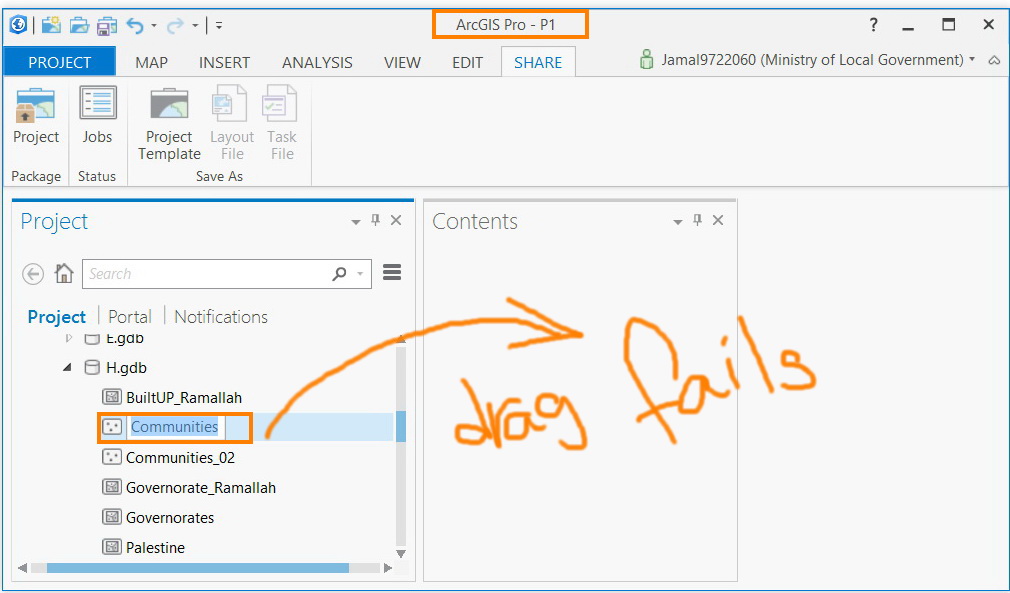

I couldn’t figure out why the drag\drop of feature classes is not working in ArcGIS Pro

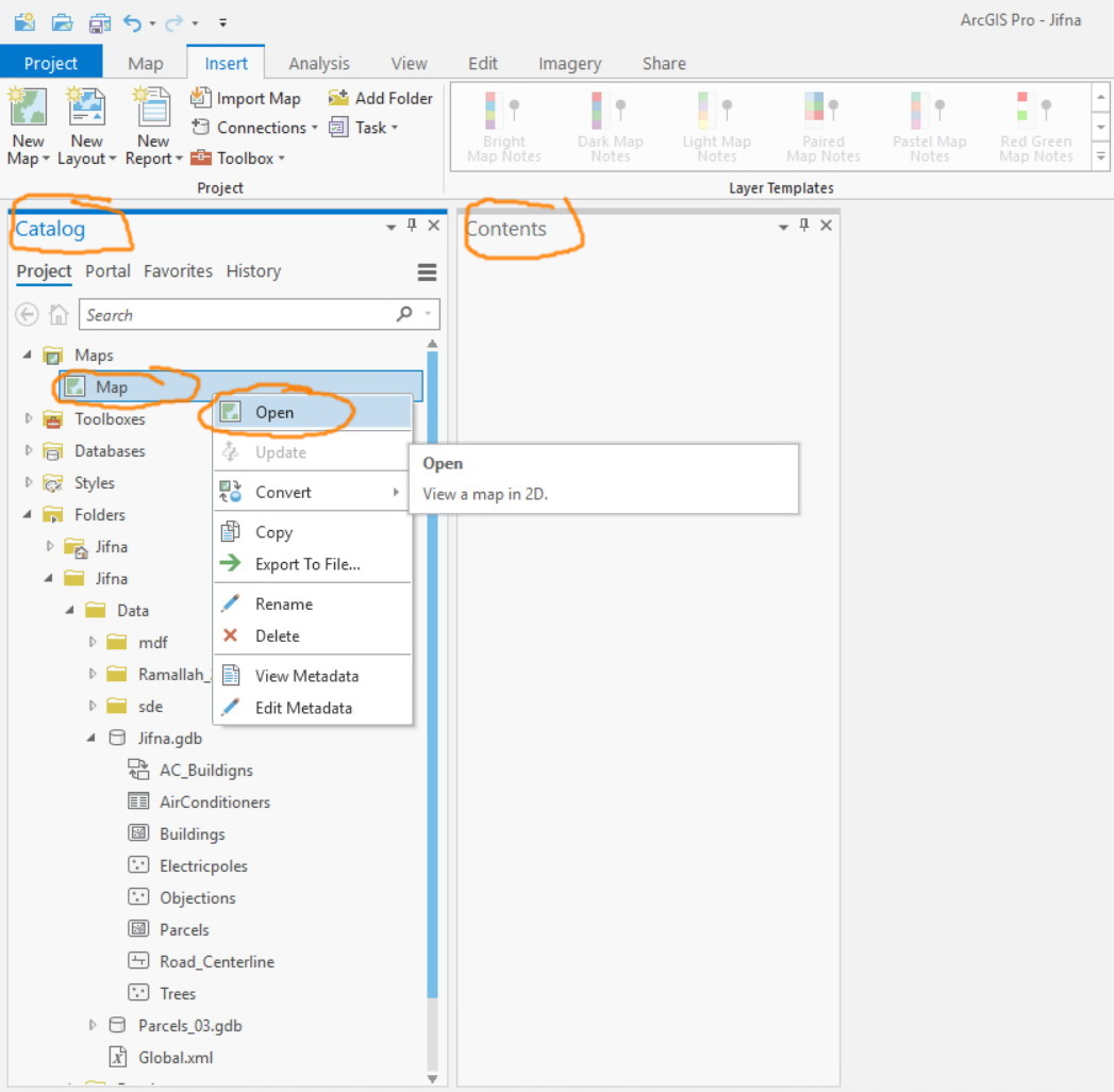

"Can you confirm that you added a map to a project? If the only context menu option that is available to you is the "Add to New Map" option, then you either don't have a map in your project, or a map is present but not open. On the Insert tab on the ribbon, click New Map. This will add a new map to the project and open it. Then you can drag/drop a feature class to a map, or right-click it and click "Add to Current Map".

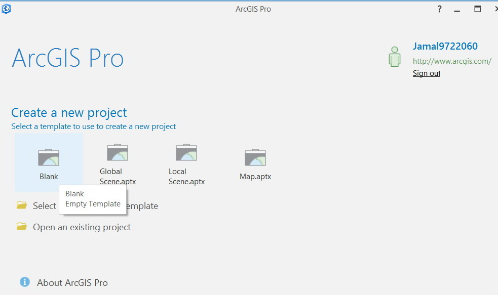

I have created a blank project and then tried to drag drop a feature class from “H” geodatabase which appears not to work (as shown in the screenshots below).

Right, I see that you have created a project, but have you added a map to it? You won't be able to drag and drop feature classes unless you have a map in your project. Try selecting New Map on the Insert tab.

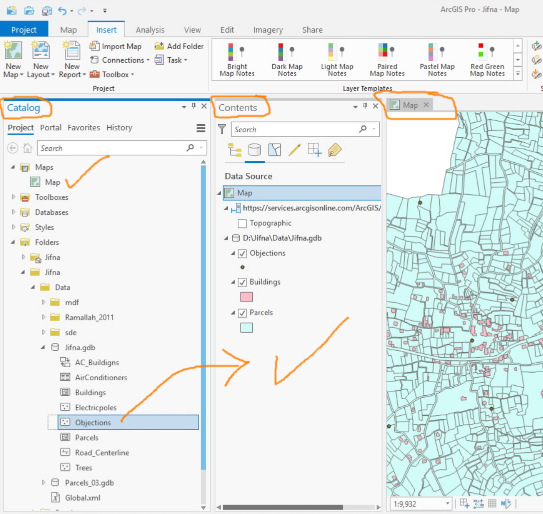

You need an extra step in Pro -> Insert map.  When you insert a map you can drag and drop contents to the maps Contents pane.
