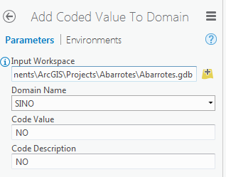

I'm trying to set domains to validate data entry into my collection method but are unable to do so because the buttons are greyed out:
Using the toolbox, I have created a domain
and added the Coded Values to the domain
But still the buttons are greyed out.  I have tried using different tables and it happens every time.
Any ideas on how to bring these buttons to life?

mhh... I thought that was it, but still are greyed out and can't access them.
The domain seems to be correctly created as it appears on the list whenever I try to add a coded value to it.
Any other things that come to mind in order to be able to use the Domains on a table?
