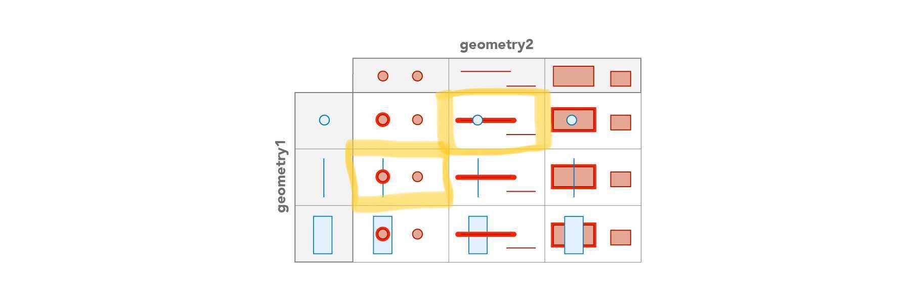

When using the Arcade Intersects()  function on a point and a polyline:
Is a search tolerance used?
The reason I ask:
If I were to zoom in enough, I would think that the point would be close to the line, but wouldn’t truly intersect the line. (Unless the line has a vertex that is exactly the same as the point.)
If that’s the case, then is it implied that a certain search tolerance or buffer is used? If so, how big is the tolerance?
Image source: Arcade Intersects() function docs
