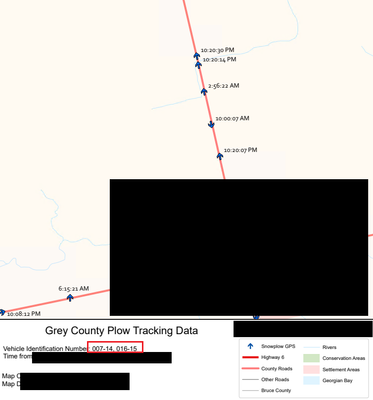

In the below image I am looking for an automated way to update the red highlighted section. I've had to redact a few sections of the image but the red outlined area is the only thing that can't be updated automatically.

Ah okay now I understand.  Yes, you can do this.  In the Layout, select Dynamic Text, then Table Attribute->Value.  When the "Insert Table Attribute" pane opens, change the Query dropdown to "Map Series Rows" in the Source component, select your Field in the Appearance component and click OK.  When you change the Map Series for each vehicle the dynamic text attribute updates with the name of each vehicle.  See attached image.DynamicText.JPG

Thank you for your reply robert, but I think it's still not quite what I'm looking for. I would need to do a map series based on vehicles in order for that to work, correct?
I am ok with multiple vehicles on the map at any one time but I only want to know which vehicles are there during the time frame I specified. I dont think what you suggest would work like that, would it?
If I could create a map series based on time intervals automatically that would also be useful. e.g. a map for every 1 hour increment over 7 days.
