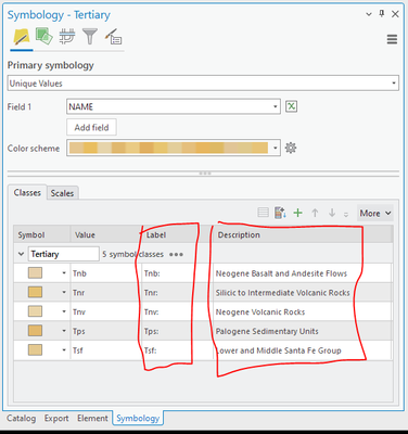

However, you could add a second map that has all the points symbolized according to the colors in the legend then not turn on that map frame (uncheck it in the Contents pane or move it off the page). If you did that and created a legend based on that map frame you'd get all the colors. I recommend creating your map using the unique values symbology type. That will support all the colors and allows for you to set separate labels and descriptions.

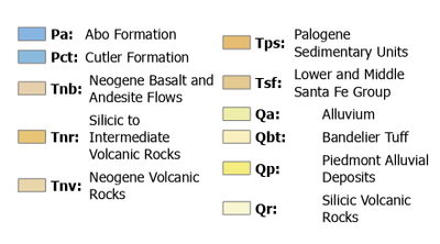

Then the bolded text would be the label, which is pulled automatically from a field (although you can override it) and the other text would be a description that you would have to add manually. With all that done, your legend would display all the text and you can adjust the word wrapping, text formatting, and spacing to get a result you like.  ArcGIS Pro doesn't currently support vertical stacking for descriptions and text though, so you won't be able to get the exact legend show in the current map. It would be something more like this:
where the bolded text would be in front of the other text.
