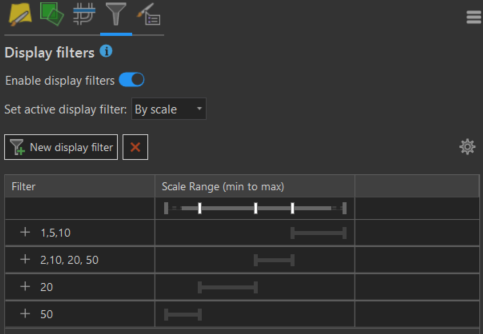

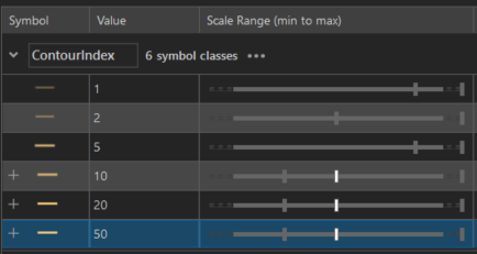

I'm creating a multiscale map of contour lines, with the intention of publishing vector tiles. To do this, I've used a combination of scale based symbology and display filters to control when and how different contour intervals show (e.g. 1m, 2m, 5m etc.) at different scale levels.
However, when I try and copy this symbology to different layers, only the scale based symbology gets copied - the display filters do not get applied to the new layer.
Is there any way to apply display filter setting like regular symbology to layers with the same schema? I have many contour datasets with different sources, and merging them into a single layer would be challenging due to the quantity of data.
For context, the settings of my layer's symbology are shown below, using a contour index field representing intervals (1,2,5,10,20,50):

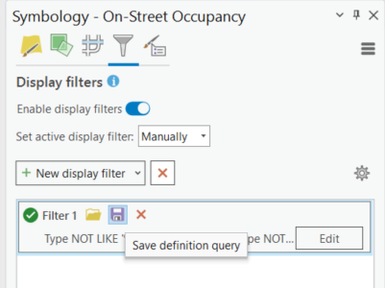

Bitzios01
I had the same issue with trying to apply filters to multiple layers. So far my solution is to save the filters and then load the filter in the new layer.
I only had four layers to apply the filer to, unsure if there's a way to do it over a lot of layers.
