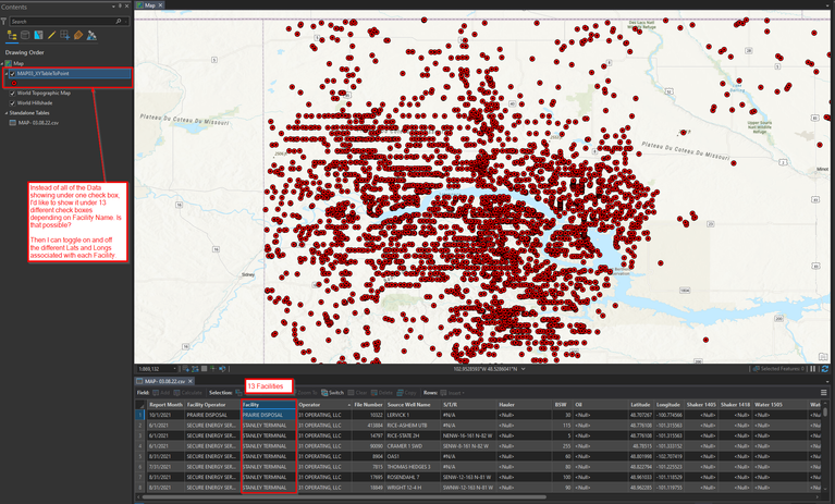

Falko26
Hey Dan,
Thanks for the reply. I'm not sure how to leverage what you sent to fix my problem.
What I'm trying to do is split up the lat and long line items by facility name so I can toggle on and off the icons depending on the attribute. See Picture.
Is that possible?

DanPatterson
MVP Esteemed Contributor
Split By Attributes (Analysis)—ArcGIS Pro | Documentation but it would produce separate featureclasses which I am not sure you want
