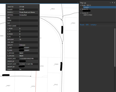

Here is another example of the glitchy-ness. This is from using the Explore function. Anything clicked when using that setting will result in a pop up panel with an empty attributes section that instead displays on top of the center frame of the UI. All it does it float there and block visibility of the data being displayed underneath, but you can't interact with it by clicking on the floating area, however you can scroll through it by scrolling from the panel where it's supposed to be displayed. Clicking on the ghost of it will just select a new feature on the map.
