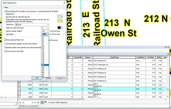

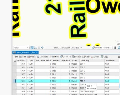

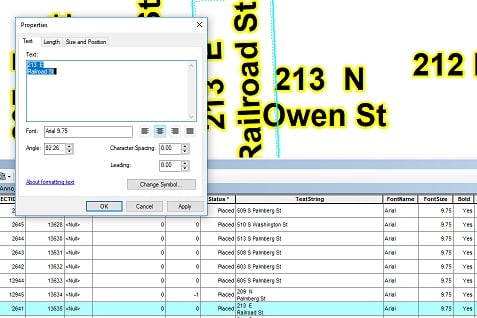

How can I display multi-lined attributes in Pro?  In ArcMap you do it by changing the cell height.  It is NOT a wrap text scenario.  It was created in the text properties (see below).  I also have some other multi-line attributes which were created using python \n with the same problem.  How can I change the appearance of the cell height in Pro?  Is this just yet another thing they decided not to include in Pro?
Text properties in ArcMap:
How to change in ArcMap:
Pro?:

  You linked me back and forth to both my question and idea.  So is the answer no we cannot see our multi-lined attributes in Pro?
KoryKramer
Esri Community Moderator
Hi Matthew - sorry that I didn't communicate more clearly (been out of the country for a few weeks and sifting through the "backlog")   Yes, this is not possible in ArcGIS Pro - I just cross-linked the Idea and the discussion for discoverability.  Thank you for posting that and I see that you already marked it as an arcmap equivalency idea so it will be reported that way in discussions with the development teams.
