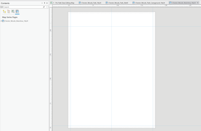

This just happened to me the first time today in ArcGIS Pro 3.3
I'd been working on various layouts in this project all day today and this is a pro project I've worked in all month and is probably a few years old. My project has like 15 layouts in it. There is one particular layout that this is happening to, is happening repeatedly. I've redesigned it twice now (as a duplicate layout and deleted the original "clear out" layout, saved, reopened, and is completely blank again. This project is stored on a shared internal network, and has global protect VPN. None of the other layouts in this ArcGIS Pro project are showing this behavior (knock on wood). I was actually working on a different layout in this project when Pro crashed and reopened to the layout in question being "cleared out" this second time.
The first crash - I was not offered to open a backup which is unusual but I re-did my work. Second time there was a crash. Same thing. Thankfully had saved just before. I was simply modifying some symbology on some line work when Pro crashed both times. The maps are pointed to hosted services in ArcGIS Online.
This second time I actually duplicated another layout (that didn't experience this behavior), re-designed it, and gave it the same name as the "clear out" layout. So I'm wondering if it's a corrupted layout file and I need to delete it somewhere on the network and re-using the name just pointed back to the corrupted layout.
Any place I should look for a corrupted layout file?
Teresa Blader
Olmsted County GIS
GIS Analyst - GIS Solutions
Teresa_Blader
The layout in question that is clearing out after crashing/saving/opening/clearing/duplicating/crashing/saving/opening/clearing:
Not sure how these will look when you open them. "Campground" is working and was used to duplicate and create "MainArea"
