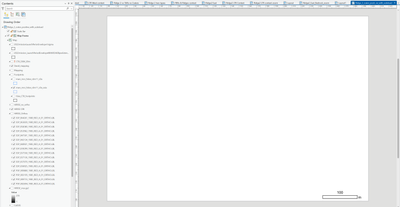

SimoneSilvestro
All,
I think I've found a workaround. Summary: my layouts are disappearing randomly (they are there but empty,  see enclosed). I am on my pc (no shared drive). So, I've tried to go on 'layout properties' (right click on layout name), then I've lpayed with the options there 'Map series', 'bookmarks' etc. I don't know how, i was able to have my layout back. Of course, this does not adress the main issue, but hopefully it can help. @AprilJohnson2 @Nelson_Schaefer

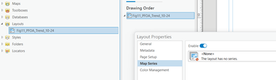

DrewCover
Not a bad thought.  I was not able to reproduce the workaround on a copy of a failed layout I have.  (esri; you can have a copy if you want for troubleshooting or reproduction, I found it a few weeks ago.)  My layout no longer registers any objects, elements, or data frames at all.  Its a time-series figure, there should be 12 data frames on it.  BUT, I did notice that Map Series is indeed enabled in the layout properties --> this was never setup and is frozen in the 'on' position, I cannot select from the series-type dropdown.  Maybe its a clue, pasted below
