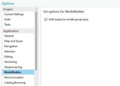

@ShitijMehta \ @KoryKramer  will this functionality be removed or at least allow me to turn it off in the new and up-coming ArcPro 3?
KoryKramer
Esri Community Moderator
Hi Duncan. Here is the option in ArcGIS Pro 3.0 scheduled to be released June 23rd.
by Anonymous User
Not applicable
OMG! Great news!!!
