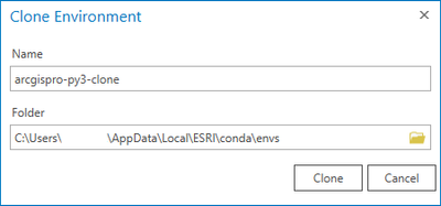

First, you need to create a cloned Python environment, as the default one cannot be modified. In the ArcGIS Pro Settings, choose Python and click on the Manage Environments button.
Find the default arcgispro-py3 environment and click on the Clone icon.
You can choose a name and location for the environment, but I recommend you leave them as default. Click the clone button.

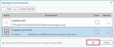

The installation will take a little while. When it is finished, click the radio button in the clone to activate it and click OK. As shown by the message you should restart ArcGIS Pro so it will use the cloned environment.
To install the deep learning packages you will need to use the command line. In the Windows start menu choose  ArcGIS - Python Command Prompt. Make sure the command prompt is using your cloned environment (at the left of the prompt). Type conda install -c esri deep-learning-essentials=2.8 and press enter. Conda will search for the packages to install or upgrade and show you a list - press y to proceed.
