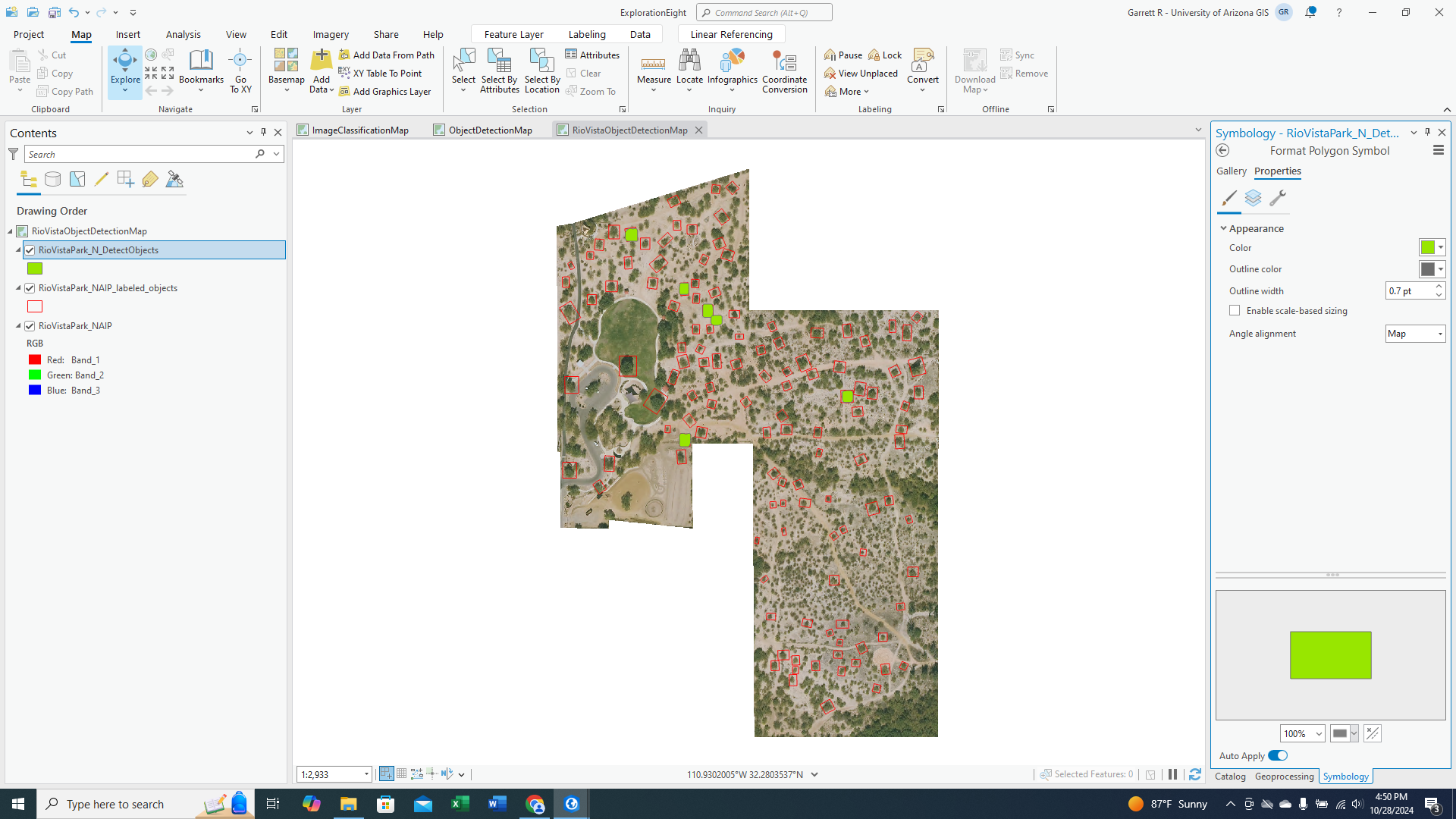

I am including a screenshot of the most recent process.
As you can see from the above screenshot, out of 125 training samples it was only able to correctly identify five trees that I trained it to identify and one that was not part of the training dataset.

When labelling the training sample, it is better to zoom into a small area and comprehensively label all your desired objects (e.g.individual trees in your case) without any missing . Then you only export the comprehsnively labelled area to your training data by setting extent in the environment tab. Train your own model with just the small area and then you can detect the trees of the entire image with the trained model. The key is to ensure you mark out all the desired objects for your training area.

Hi @GarrettRSmith, I have few points which can be helpful for you.
  • From the image which you have shared I can see that the image has shrubs and trees both in the imagery which can confuse the model as visually they are very similar.
  • Secondly ,125 samples are very less for training a tree model. The suggestion by @clai  for labeling all trees in an area and only exporting that area is also very important. If we label trees sparsely the model will get confused because few trees are labelled and few are missing.
  • If your objective is only to identify trees in this area using a deep learning model you can use our two pretrained models named "Tree Detection" and "Tree Segmentation" from ArcGIS Living Atlas of the World. Our pretrained model is trained on millions of data.
