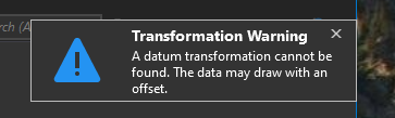

I upgraded ArcGIS Pro from 10.8 to 10.8.1. When opening existing layout  created from ArcGIS Pro 10.8, the message below pop up every time I open up any layout created from older version.

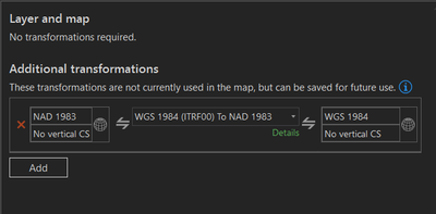

I tried to fix the issue but the second transformation shown below cannot be edited.
Any suggestion to fix the issue would be greatly appreciated.

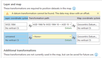

Please check if any layer has a custom (or unknown) spatial reference. This may happen when data is created using any other software.
You may remove the layer or define a standard spatial reference from within ArcGIS Pro (if appropriate). Else, ignore the transformation warning.
You may also navigate to the Project tab > Options > Map and Scene > Spatial Reference and uncheck the box for Warn if transformation between geographic coordinate system is required to align data sources correctly.. See transformation tips in Projection on the fly and geographic transformations

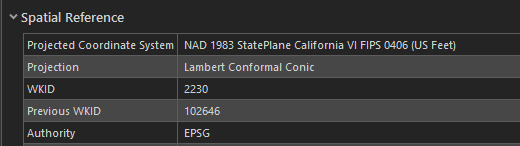

I am getting the error anytime I open a Portal map with layers publishing in our local projection California State Plane VI within a web map, which to my knowledge when using an Esri basemap always uses Web Mercator auxiliary sphere. However the transformation seemed to be applied without error in the past, is there a new step we should be taking when using Esri basemaps? And if so, what is the best way to correct it?
