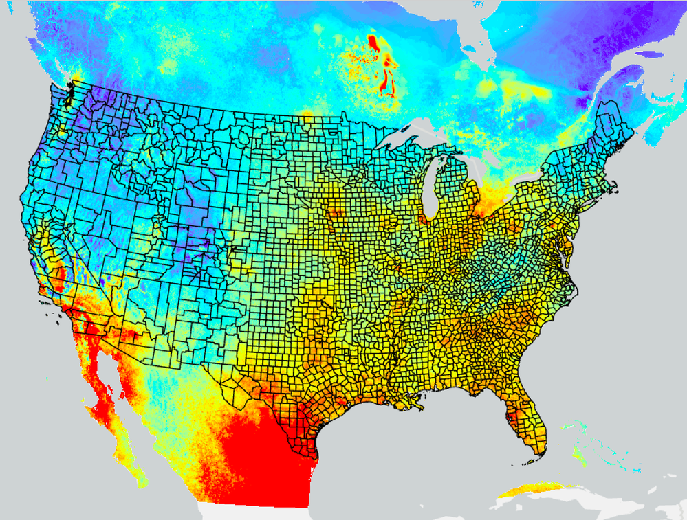

I have many .ncf files that I read as raster layers and then do zonal statistics to have mean and sd values over each of 3108 CONUS counties. But the final standalone table is missing 245 counties. This is how the raster layer and the counties look together. You see that the raster covers all the polygons
feature layer on top of the raster layerfeature layer on top of the raster layer

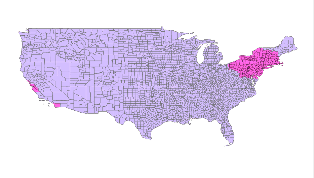

And the picture below shows missing counties  from the resulted zonal statistics in red color.Red counties are missed from the final tableRed counties are missed from the final table

Mystery solved!
The problem was that I had projected my shape file to the projection of my raster files (netcdf). But the raster files did not have any projected coordinate system (only contained Geographic Coordinate!). So, I solved it the other way. Now before doing the zonal statistics, I project each raster into my shape file projection that contains both GCS and PCS, using this command:
