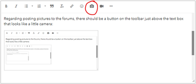

Regarding posting pictures to the forums, there should be a button on the toolbar just above the text box that looks like a little camera:
