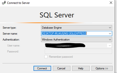

KimberlyGarbade
I usually steal the instance name right from SSMS when I can't remember it (which is more often lately).  Its the same as the Server name in the SSMS database connection dialog:
