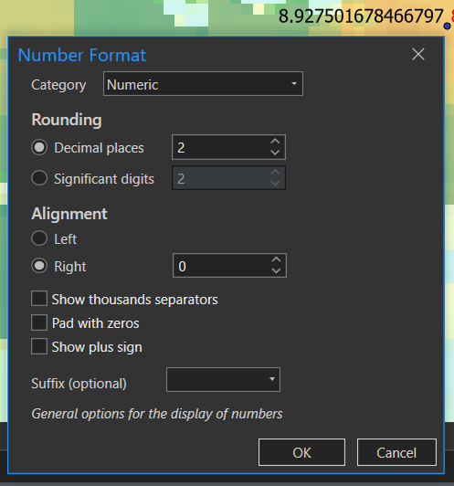

In ArcGIS Pro 3.1 in the attribute table of my points feature class I have limited the decimals of a numeric field to 2 decimal places using the rounding option:
After applying the changes, the numbers display correctly in the attribute table. However, the labels on the map still show the full extent of decimals (see upper right of the image) without the rounding applied.
How I can achieve the same 2 digit display in the labels as in the attribute table?

teakplantation
Thanks Dan!
In my  case round(number($feature.RASTERVALU), 2) using Arcade 🙂

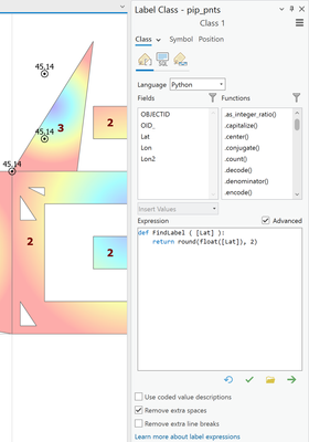

JerryJ
Using the script above, numbers ending with .00 are labeled without the .00, i.e., 29 not 29.00
