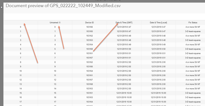

I see the same issue until I add a column title for the missing column, and remove the invalid column names (spaces, special characters, etc).
If I ensure ALL the fields have a name, and that name is a single word, then it converts to table as expected with date and time in the fields.
If you run the Table to Table GP tool in Pro, it appears as if it "fixes" these issues on the fly.  With the python code, however, I had to fix the column name issues before it worked.

I've noticed the same behavior in the Table To Table GP tool in pro if I try .csv or .xls.
However, if I open the csv in Excel and save as .xlsx, then the date/time imports as expected.
