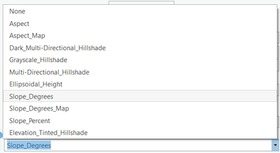

I think Make Image Server Layer (Data Management) will suit your requirement. You can use the following URL as the Input Image Service parameter: https://elevation.arcgis.com/arcgis/rest/services/WorldElevation/Terrain/ImageServer
Choose a suitable processing template (None=Elevation; Slope;Aspect, etc.).
Keep the extent smaller.
Then use Copy Raster (Data Management) to save it as a TIFF/IMG etc.
