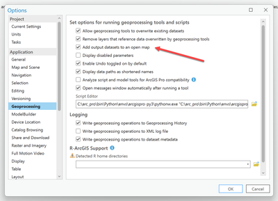

if you specified the workspace as a folder, then they are probably shapefiles and you would have to add them manually to the map.  It is best to specify a file geodatabase and make sure this is set in Project, Options, Geoprocessing

split by attributes should produce a featureclass for each unique class in the field you chose as the identification field (eg home range ? )
