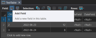

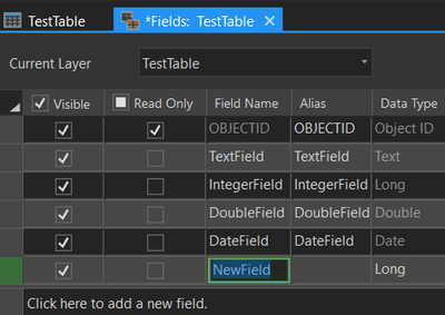

  • Open the attribute table, click on Add Field
  • Enter your field info
  • Save your changes
Have a great day!
Johannes
DEVANBarrett
Hey Johannes, thanks for the information but I am looking at creating a new Column, not a new row. I think that I need to Join two tables but I was messing up the proper steps to do just that.
BarryNorthey
To add a field (column) to a table, Pro opens up a Fields View of the target table as shown in Johannes' screen captures. Each field in the target table occupies (is defined in) a row in Fields View. This where you define the new field's structure (Name, Data Type, etc) --> Save --> close. The new field will appear in the target table ready for use.

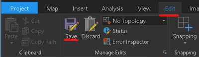

If you want to add new rows manually, it depends on whether you work with a pure table or a table with a geometry field (Shapefile or Feature Class).
For tables:
  • open the attribute table, scroll down
  • click where it says "Click to add new row"
  • A new row gets created, you can input your values.
  • Save your edits

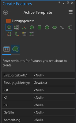

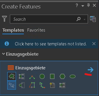

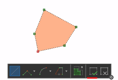

For Feature Classes:
  • open the feature creation panel
  • in the panel, click on the feature template you would like to create. If you click on the arrow to the right, you can input the attributes of the feature.
  • Choose one of the geometry creation methods and draw your feature on the map. FInish by clicking on the button, pressing F2 or double-clicking.
  • Save your edits.

Hopefully you got this figured out since it was a long time ago but for anyone that clicks on this hoping for answers and is still confused, Clicking add new field does indeed make a new column in the attribute table. It looks like it makes a new row because it takes the list of columns and turns them horizontally in fields view, but when you go back to the attribute table you will see that a new column has been made. Hope this helps
