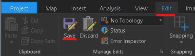

  • Open the attribute table, click on Add Field
  • Enter your field info
  • Save your changes
Have a great day!

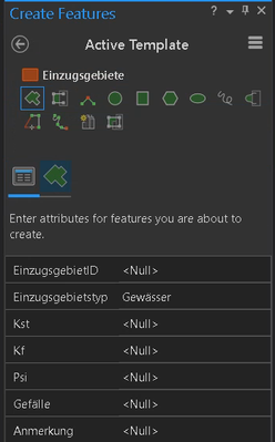

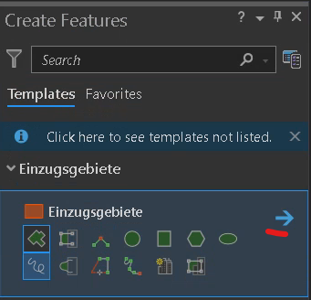

For Feature Classes:
  • open the feature creation panel
  • in the panel, click on the feature template you would like to create. If you click on the arrow to the right, you can input the attributes of the feature.
  • Choose one of the geometry creation methods and draw your feature on the map. FInish by clicking on the button, pressing F2 or double-clicking.
  • Save your edits.
