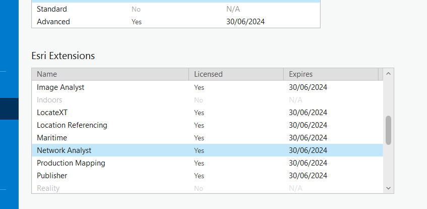

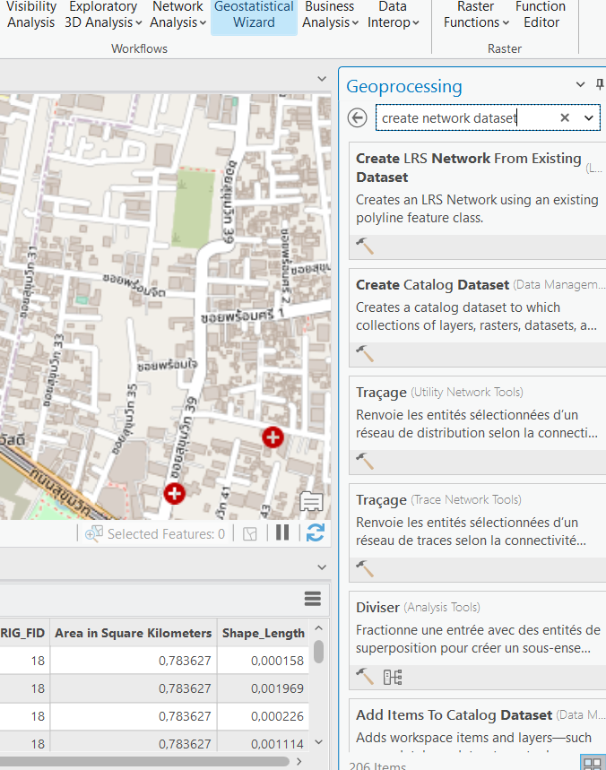

I would like to create a network dataset from a .shp file, but the tool "Create Network Dataset" doesn't appear in Geoprocessing (first pic). I am supposed to have the Network Analyst extension installed (second pic)

I really need to get this Network Dataset for my work.

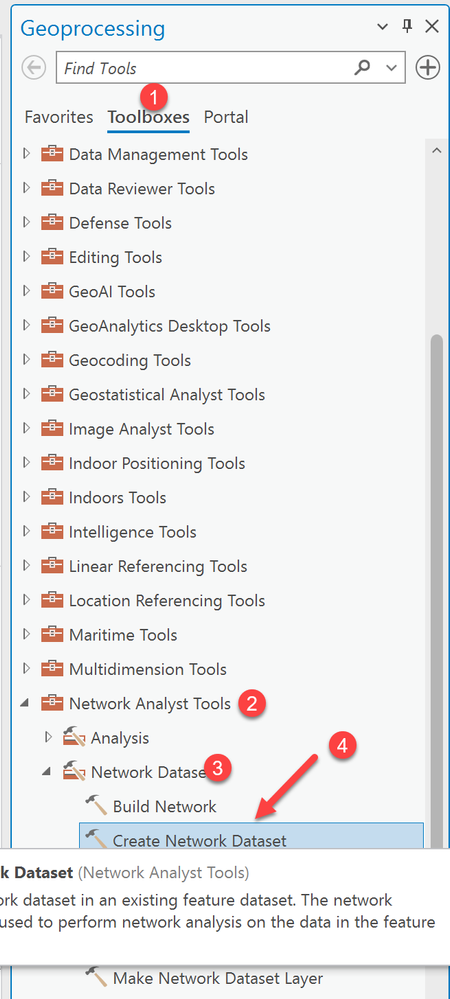

Try navigating through the toolboxes.
  1. Click on the Analysis tab from the ribbon
  2. Select Tools
  3. Click on the Toolboxes tab at the top of the Geoprocessing pane
  4. Expand the Network Analyst Tools toolbox
  5. Expand the Network Dataset subset
  6. Find and select Create Network Dataset
Also, it looks like some tools show in English while others show in French. The Create Network Dataset tool may be one that shows in French. It may show if you search for the name in French instead of English.
