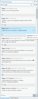

Also, don't use copy rows. It will wipe out your existing table. Please fix your tool description in ArcPro for Copy Rows.
"Copies the rows of a table to different table" implies that you are copying the rows from one table to another table as long as the fields match.
The following statement from Copy Rows (Data Management)—ArcGIS Pro | Documentation means something entirely different.
  • The tool copies the rows of a table, table view, feature class, feature layer, delimited file, or raster with an attribute table to a new geodatabase or dBASE table or a delimited file.

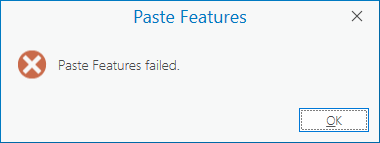

When using the described method in that link for GDB Tables, I get the following when pasting.

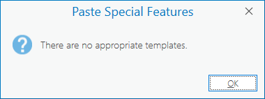

If I try to do paste special, I get the following.
That would be the methods I use for copying and pasting and feature into the same feature class or a new feature class. This does not appear to work for GDB tables.

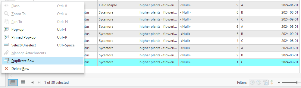

As of ArcGIS Pro 3.1, it's possible to duplicate a record in a standalone table using the duplicate context-menu option in the attribute table.
