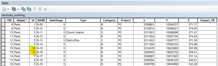

I'd like to calculate an ID field (or some other numeric field) with consecutive numbers starting with 1. The order of this field will be based on the longitude field since I want to number my points from South to North.
I found this https://support.esri.com/en/technical-article/000011137 but it is based on the record number and not a field in the data. I have  put a portion of my table below.
Is this possible? This has stumped me for years!
