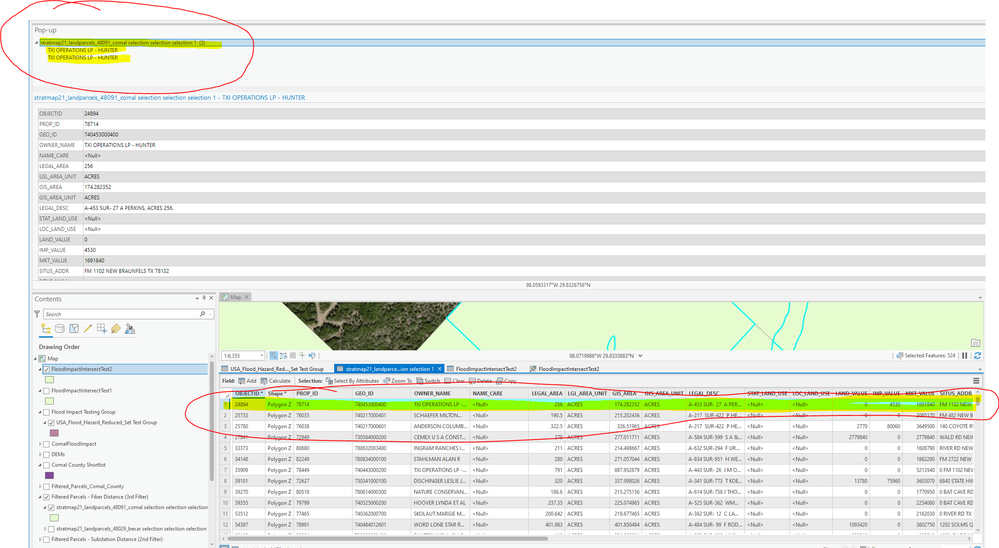

JohnCordisco
@Sean_Wray,
After comparing the "Land" attribute table and selecting the polygon on the Map, the pop-up has two records although the attribute table only shows one. Could this be the part of my issue?
