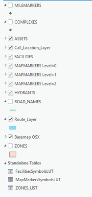

I'm using ArcGIS Pro 3.5.2 (and this was occurring at 3.5.1, but not prior version) and when I use the "Create mobile Map Package" I get the error:
160718: The item does not have a definition.
The map has a vector tile cache (as a basemap layer), several feature layers, and a network dataset, a 3 tables.
How in the world am I to determine which items does not have a "definition"?
Also, I removed the network dataset and still got the error.

I removed one layer at a time and did the create MMPK until it completed without error. It was the "Route_Layer" which is a line feature layer in a file geodatabase. I have no idea what "definition" was needed, so I did follow the advice from the Tech Support AI BOT and exported the layer to a Shapefile. Then I used the Shapefile while creating the MMPK and it completed successfully.
Wish I know what "definition" was needed so this layer functioned as expected.
