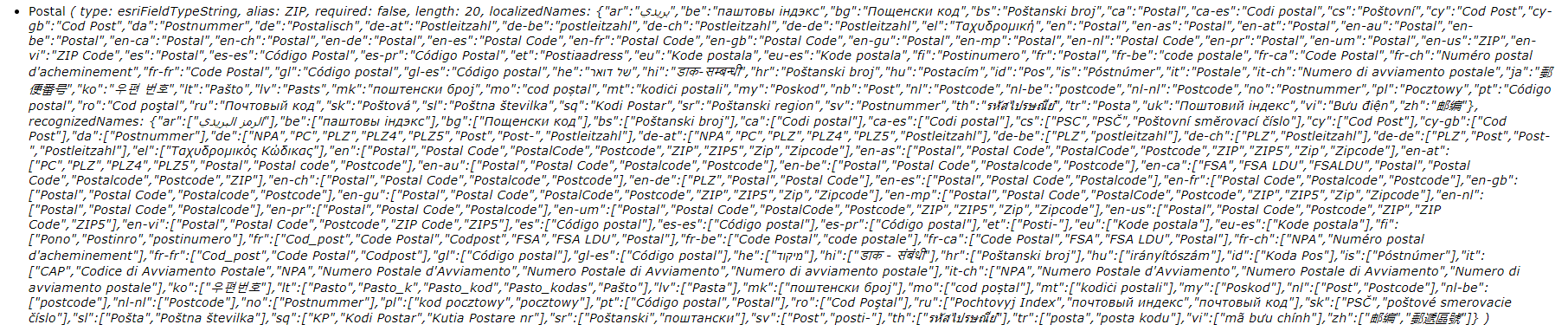

  3. When looking at the GeocodeServer page of the published locator, the fields have this long list of localizednames. Is there a way to remove them entirely and/or customize which localizations show up? JoshKalov_0-1633104635485.png

3. It's not possible to remove or customize the localized names for the locators created with the Create Locator or Create Feature Locator tools that are published as services.

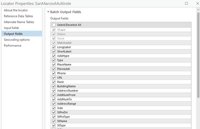

Nitin_Kulkarni
Hi @ShanaBritt ,
We are using ArcGIS Pro 3.0.5 (as we cannot upgrade to 3.3 yet) and ArcGIS Enterprise 10.9.1. Created a composite locator using Create Locator tool, checked only a few required fields (for example: Address, City, Region, Postal, Country) under Locator Properties > Output fields, published the locator as a geocode service, still we see all fields at the REST endpoint for the GeocodeServer.
Could you recommend any other way to limit the number of output fields for the geocode service?
Thank you!
Nitin.

ShanaBritt
@Nitin_Kulkarni Can you provide more details on how you are using the service? Are you using the geocoding operations via the REST endpoint pages or are you using the service in a web app or ArcGIS Pro?
The Address and Candidates fields section of the geocode service's service description page are not tied to the Output fields section listed below in the Locator Properties dialog in ArcGIS Pro. The Candidate fields represents all of the possible fields that can be returned by the locator in the geocode result.
Nitin_Kulkarni
Hi @ShanaBritt
We are using geocode operations via the REST endpoint page.
Thank you for confirming that the geocode service's description page is not tied to Output fields section in  ArcGIS Pro.
ShanaBritt
@Nitin_Kulkarni Are you just using the REST endpoint page to test that the service is working? What value are you passing in the Out Fields parameter in the findAddressCandidates request? Are you trying to get specific fields returned? If so, then you would specify the fields you want in a comma separated list. https://developers.arcgis.com/rest/services-reference/enterprise/find-address-candidates.htm#ESRI_SE...
In Pro 3.0 and Enterprise 11.0 we added "enabledOutputFields" so that the fields enabled in the output fields section of the locator properties are only returned in geocode results in client applications. This enhancement fixes the problem described in post you referenced above, Limit Geocoding Information Returned by Locate Tool in the Locate pane and in the Show Details pop-up. The "enabledOutputFields" property listed on the service description page for geocode services published to Enterprise 11.0 or later is not used in REST requests. If the service was added to Pro, the fields in the "enabledOutputFields" list would be returned for the results in the Locate pane.
