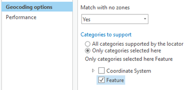

In the Locator Properties - Geocoding options - what does this mean if I check Feature in Categories to support?

Locators created with the Create Feature Locator tool only support two categories, Feature and Coordinate System. If you only check Feature, then no results are returned if you searched for XY, MGRS, or USNG coordiantes. See https://prodev.arcgis.com/en/pro-app/latest/help/data/geocoding/tips-for-improving-geocoding-quality... for more details about Categories to support in Geocoding options.
