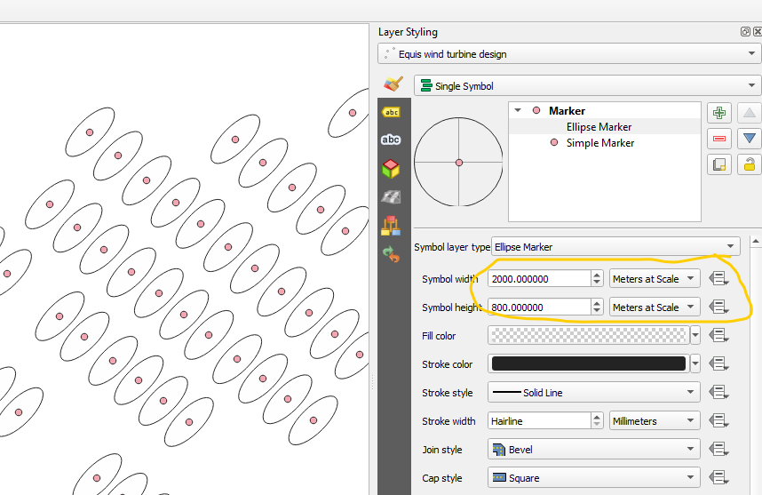

In QGIS it is possible to create point feature symbols that include
- a point to show the feature location
- an ellipse to show characteristics of the point, derived from feature attributes, and which draws the ellipse to be correctly sized according to the current zoom scale (note ability to select 'Metres at Scale' below and to source the relevant dimension from attributes)?
I have spent quite a bit of time trying to work out how to do this in ArcGIS pro without success.
Does anyone have way to replicate this kind of symbology in ArcGIS Pro? (Ideally attribute table parameters for ellipse width, length and rotation would drive the symbology.

Thanks Rebecca - your solution creates ellipses well enough, however in QGIS the ellipses are actually to scale relative to the map, i.e when you zoom in or out the symbols expand or shrink and stay to match the scale.  In your option the ellipses are the same size whatever the scale, unless I am doing something wrong?
