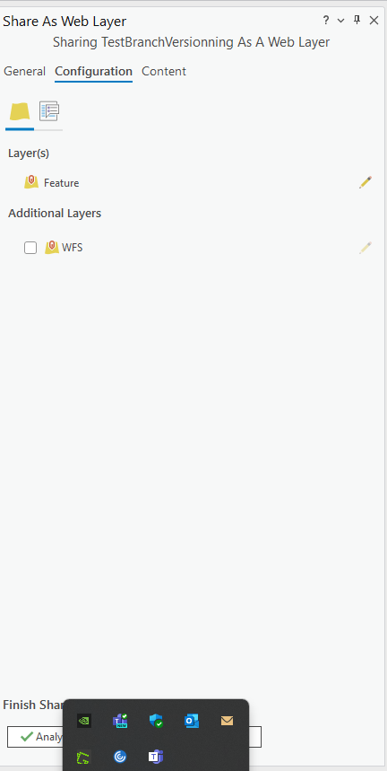

  4. Then if I add the Feature class to my map, I cannot edit it, cannot create a version, everything is disable, feature class is not editable.. Again refering to this link, this should be normal behavior.
  5. So I do Publich Web Layer. In the Share as web layer form, there is no check box "Version managment" visible. All the videos I've watch doing demos of this have that check box. Why it`s not there?
  6. So I go ahead anyway with the publication..

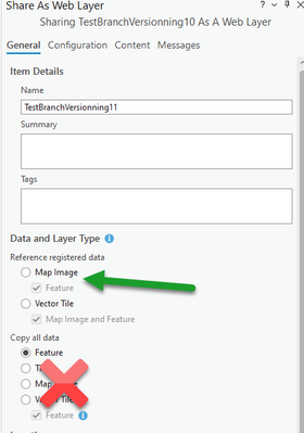

Ok, thanks for the screenshots. On the "Share as Web Layer" dialog box, you MUST have the "Reference registered data" option checked, NOT the Copy All Data. See screen shot below....
If you select the green arrow option (not Vector Tile), does Version Management show up?

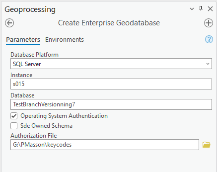

Here is how I created my enterprise GDB. My user is sysadmin on our MSSQL instance.

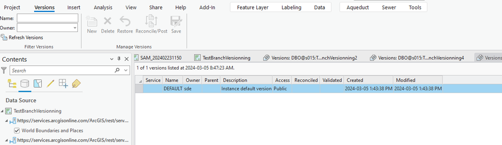

But once branch versionning is set up here is what I have in the version managment

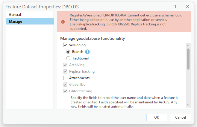

I'm not even sure of the procedure of how to set up my GDB branch versionning.. I try to redo it to get screenshot to reply to here and I get this error when setting branch versionning on the Feature class.

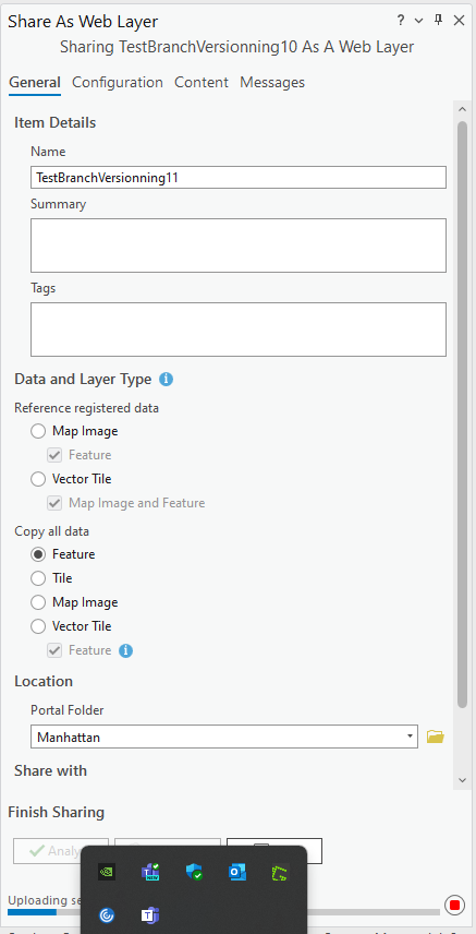

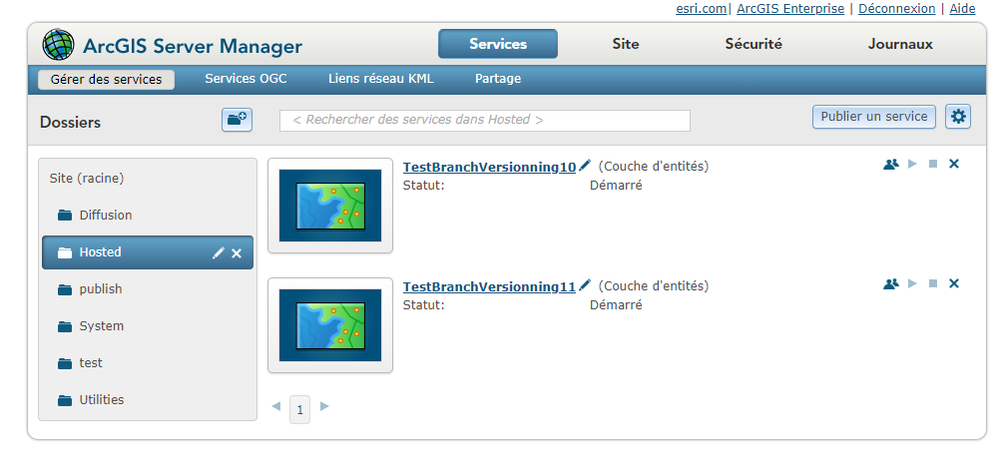

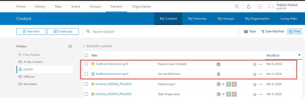

When I move forward with the publication, the Feature Service becomes a Hosted Layer on our ArcGIS server. Why is it "hosted"?

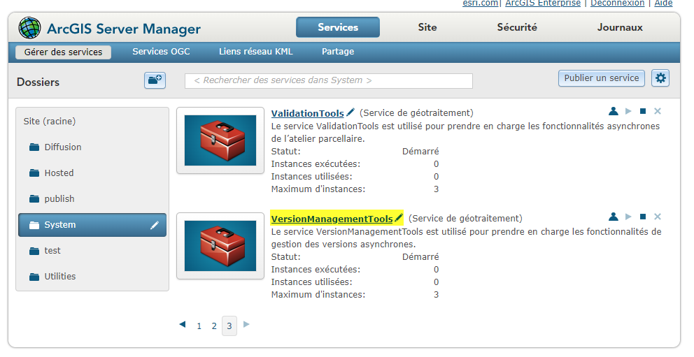

I went to check if the version managment thing is enable on the server and it is.
--- George T.
PierreMasson
Ok, that was a big step forward! I now see the Version Managment check box!
thank you for spoting that!

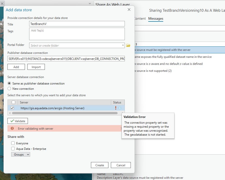

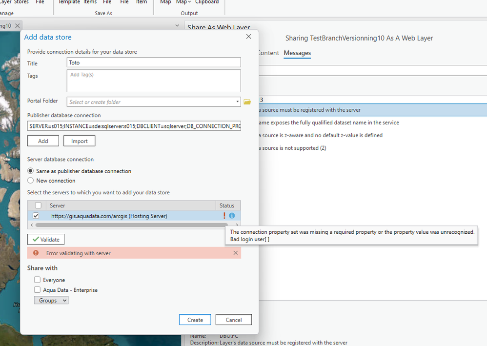

I get an Anylize exception when doing the sharing that my Layer's datasource must be register with the server.
So I do "Register data source with the server" but I can't do it because the server validation won't pass.
We did add GDB to the data store before, I don't know where I can configure this..

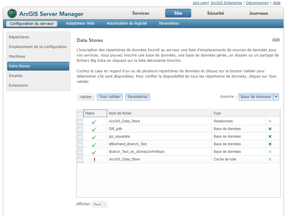

Here what I can see on our server
Everything seems to be working fine but I can't add anymore data store.. I will use one of our existing GDB/DataStore to publish branch versionned data and do my tests with that for now. But if you can help with this issue it would help us better organize our data.

Glad we got past the first major hurdle..... I am not sure on the registration issue.
Based on the connection information, are you using O/S authentication?
If so, you may need to make sure that the ArcGIS Server account has access to layers in the EGDB.
--- George T.
PierreMasson
I tried Windows and database authentification.. No luck.. I try to understand who knock on the door of who and where to go to manage that..
PierreMasson
Ok we found out the user that was running the ArcGIS Server and added that user has sysadmin of our MsSQL server and it worked! I mean the register data store problem is no more! 🙂
